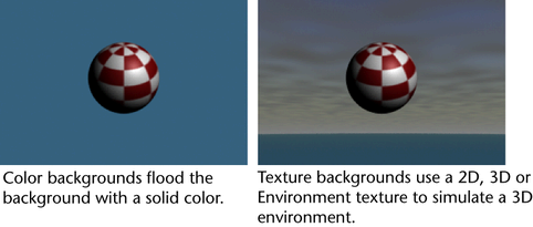

A color background floods the background of the scene with a solid color (for example, black, white, or red). To create a color background, see Create a basic color background.
A texture background uses a 2D, 3D, or environment texture on an image plane to simulate a 3D background, or environment.
To create a texture background, see Create a texture background.
