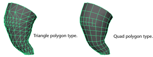

Outputting to triangles or quads
Type
Select the type of polygons to use when you convert NURBS geometry to polygonal data.
If you select Triangle (the default), 3-sided polygons are created. If you select Quads, 4-sided polygons are created.
Note:
When you tessellate a trimmed NURBS surface, some 3-sided (triangle) polygons may be created along the trim edge even when the option is set to Quads.

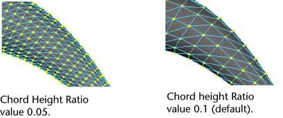

Chord Height Ratio
The Chord Height Ratio is the ratio between the maximum distance of the curve from the polygon edge used to approximate it and the chord length. The chord length is the linear distance between two polygon vertices.
Valid values range between 0 and 1, where larger values result in fewer polygon vertices.
For example, the default value, 0.1, means that the height must be larger than 1/10 of the chord length before additional edit points are created.

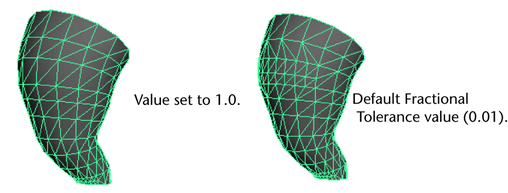

Fractional Tolerance
The Fractional Tolerance value determines the degree of accuracy maintained between the original surface and the interpolated polygonal surfaces. The default is to be accurate to within 0.01 units, where a unit refers to the current unit of linear measure (the default unit of measure is centimeters). Therefore, at no point will the polygonal surface be more than the tolerance distance away from the original NURBS surface.
In this next example, notice how you can enhance the polygonal surface’s accuracy when you change the Fractional Tolerance value from 1 to 0.01.

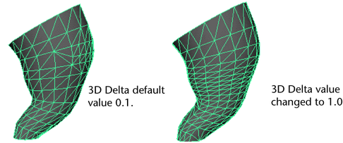

3D Delta
The 3D Delta value determines the 3D spacing for U and V isoparms on a surface that makes up the initial grid for the tessellation. In the following example, the 3D Delta value is changed from the default 0.1 to 1.0.

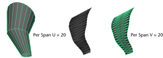

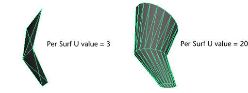

Unless Use Chord Height or Use Chord Height Ratio is turned on, a uniform tessellation is performed. Each span/surface is split into a number of polygons depending on the Number U and V values you set.
U Type/V Type
The U Type and V Type pop-up menu items let you specify whether you want to split the surface based on where the spans are (then split each span), or based on the parameterization of the whole surface.
Number U/Number V
Each span or surface is split into the number of polygons you specify here.

If Use Chord Height or Use Chord Height Ratio is turned on, you can set a specific value for both the Chord Height and the Chord Height Ratio. A value greater than 0 results in fewer polygon vertices if the ratio on the curve is greater than the current value. For example, the default value, 0.1, means that the height must be larger than 1/10 of the chord length before additional edit points are created.

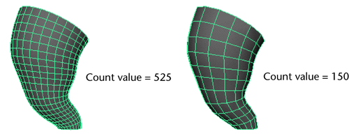

Count
Set the Tessellation Method to Count to display the following slider.
Count slider
Use the Count slider to determine how many polygons the surface can be tessellated into. See the following examples.

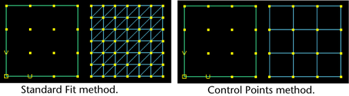

Control Points
This tessellation method converts the NURBS model to polygons while matching the CVs of the original NURBS surface. There are no other options for this operation.
