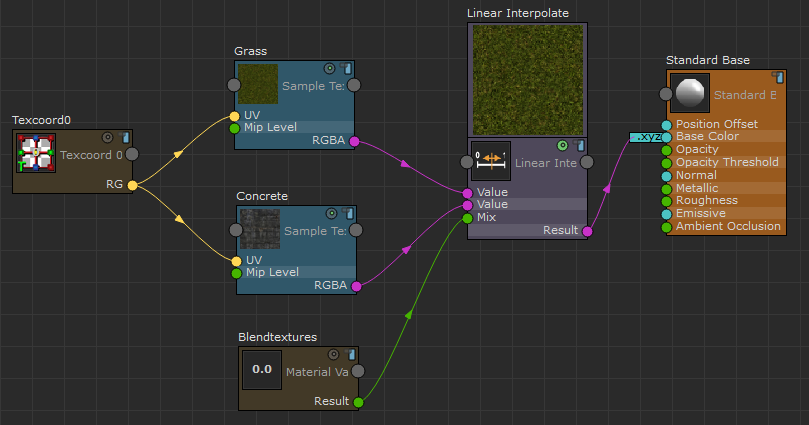

To create a texture map
To create a texture map, create a Sample Texture node, and connect to it your file texture.
You must connect a UV set node (for example Texcoord 0) to the UV attribute of Sample Texture to set the texture co-ordinates of your object.
The following simple network demonstrates how to combine two textures using a Linear Interpolate Mix node and control the contribution of each texture using a Scalar value.
Textures courtesy of www.cgtextures.com
