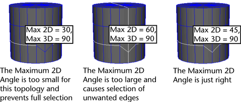

These settings determine how far the selection continues based on the angles between edges. When Maya considers an edge for selection and it exceeds the specified angles, automatic selection stops.
The 2D angle refers to angles made by the surface topology, regardless of the surface’s shape. The 3D angle refers to angles made by the surface’s shape, as measured in world or local space. The following example illustrates how the combination of these settings control the selection.
