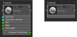

Each node has up to three icons on its top right hand corner. The icons are described below, starting from the farthest on the left:
Click the
Group icon
on the top of a group node to see its group contents.
To exit out of group mode, click Exit Group in the upper-left corner of the ShaderFX editor.
This icon is only available for nodes with an internal network; for example, group nodes, or a texture node.

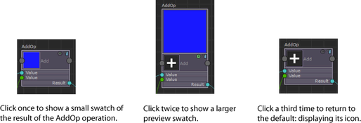

Click the
Render Swatch icon
on the top of each node to cycle through displaying: its icon, its small render swatch, and its large render swatch.
In the following example, clicking the Render Swatch icon a first time shows a small swatch of the result of the AddOp operation. Clicking Render Swatch a second time shows a larger preview swatch. Clicking Render Swatch a third time returns to displaying its icon.
This functionality allows convenient visualization and debugging of your shading graph.
Click the
Hide Inputs and Outputs icon
on the top of each node to toggle between displaying the node attributes and hiding the inputs/outputs for a more compact node view.
Nodes that are referenced from disk are marked with an R symbol.
Ports that require an input are outlined in red.
