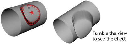

Select Push, Pull, Smooth, Relax, Pinch, Slide or Erase. A letter appears within the brush stamp to reflect the operation: Ps (Push), Pl (Pull), Sm (Smooth), Re (Relax), Pn (Pinch), Sl (Slide) or E (Erase).

In the Sculpt Parameters section, select the Reference Vector. The Reference Vector controls the direction the vertices move when you push or pull. The brush arrow represents the reference vector.
The vertices move in the direction of the surface normal.
The vertices move in the direction established by the surface normal at the beginning of the stroke.
The vertices move parallel to the camera view direction.
