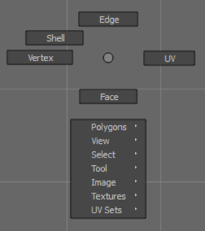

To select UVs and UV shell components in the UV Editor
