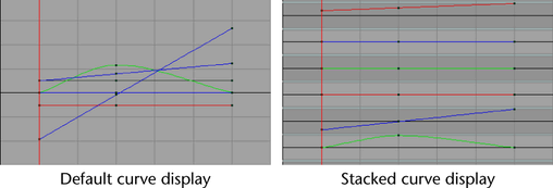

By default, curves are displayed overlapping in the graph view. You can switch to view a stack of individual curves.
To view a stacked display of curves
See also Stacked Curves for more information.
You can change the stacked curve background colors in the Animation Editors section of the Color Settings ()
When using the Scale Keys Tool or the Lattice Deformer Keys Tool with Stacked Curves turned on, you can only modify the time value.
To turn off stacked display of curves
