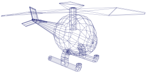

Wireframe |
Press 4 or Click the
or Choose in the view panel. |

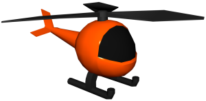

Shaded |
Press 5 or Click the
or Choose You can also choose to shade only selected objects. |

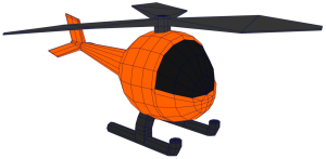

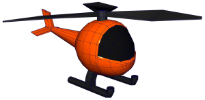

Wireframe on Shaded |
When Smooth Shade All is on: Click the
or Choose |

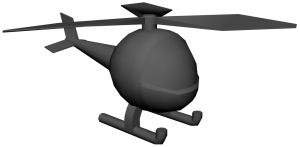

Default material |
or Choose |

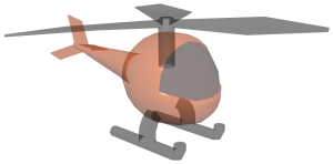

X-ray mode |
X-ray shading automatically displays objects with slight transparency to let you see and select things behind opaque surfaces. There are three X-ray display modes:

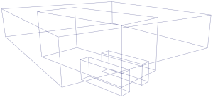

Bounding box |
Choose |

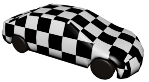

Flat (faceted) shading |
Choose or Flat Shade Selected Items |
Constant shading |
Select . You can also turn on to see the geometry wireframe on the objects. |
