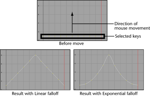

Move Falloff
Set one of the following options:
  • Constant moves all keys the same amount in the direction you middle-drag.
  • Linear moves all keys based on the distance they are from the mouse down location. The amount a key moves decreases linearly as its distance from the mouse down location increases.
  • Exponential moves all keys based on the distance-squared they are from the mouse down location. The amount a key moves decreases exponentially as its distance from the mouse down location increases.
