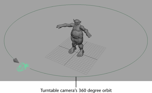

A turntable animation is automatically generated by a turntable camera. You can add a turntable camera to your scene with in the Animation menu set.

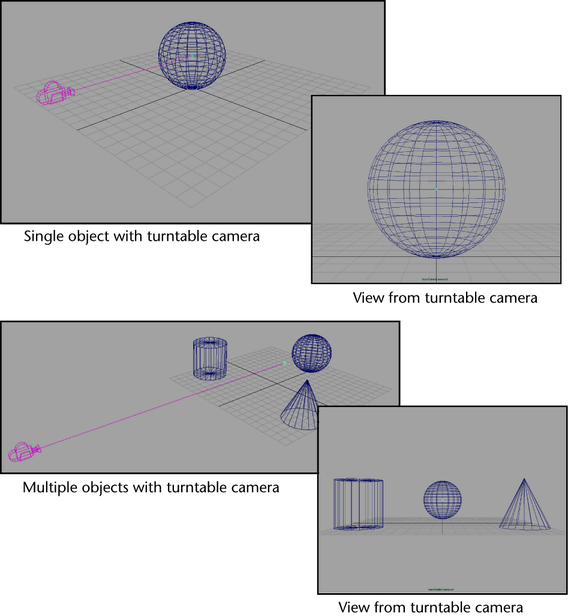

Turntable cameras are animated by default. On playback, the turntable camera follows a 360 degree orbit around its target objects. From the turntable camera’s view, it appears as if the objects you are reviewing are rotating 360 degrees.
The turntable camera’s view is locked. You can not dolly, tumble, or track the turntable camera.
