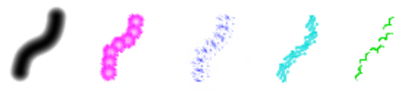

Artisan brushes use grayscale images to define the brush profile (or shape). You can select from 40 predefined brush shapes, or you can create your own shapes using any image format supported by Maya LT. You can paint, erase and clone textures using Artisan brushes.
