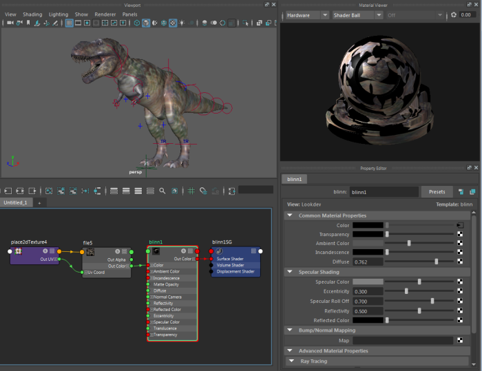

  1. Click in the status line to open the Hypershade.
  2. Select Window > Viewport from the Hypershade menu to open a viewport panel.
    Drag the viewport panel and dock it to any location in the Hypershade that suits you.
  3. From the Create tab, middle-drag the material (for example, Blinn) into the Hypershade work area.
    Tip: You can also press Tab in the Hypershade work area and enter the name of your material to create it.
  4. Select your object in the viewport, then right-click the material in the Hypershade and select Assign Material to Viewport Selection.
    Click 5 in the viewport to switch to shaded mode.
    Your object now appears shaded in the viewport with the material you just created. You can also see your material in the Material Viewer panel on the top-right of the Hypershade.
  5. Select the shader in the Hypershade and adjust its properties in the Property Editor.
    For example, click the color swatch beside any of the shader attributes, such as Color, Transparency, and so forth. See the viewport and Material Viewer update in real-time to reflect your changes.
  6. (Optional) Map a texture to any of the shader properties.
    In addition to adjusting the color swatch or values of the attributes, you can also connect a texture to any of the shader properties. Click the map button next to an attribute and select a 2d or 3d texture from the Create Render Node.
    Click 6 in the viewport to switch to textured mode to see the texture on your shader.
    Tip: To connect an image texture file, map the File node.
