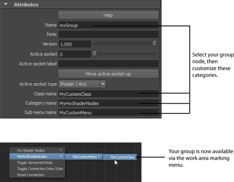

icon to visualize the group network.
Your group node, now renamed to Name, is accessible when you right-click the work area, and appears in the marking menu as Category name > Sub menu name > Class name.
