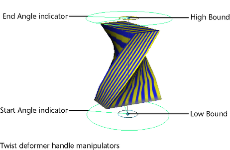

To edit twist deformable objects by using handle manipulators
  1. Select the twist deformer node (default name: twistn).
  2. Select the Show Manipulator Tool (default shortcut: t key).
  3. In the scene, select one of the manipulators on the twist deformer handle.
    The manipulators on the twist deformer handle let you edit attributes.
  4. Middle -drag the mouse to edit interactively. Note that the Channel Box updates the values you are changing.
