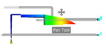

The Pan tool enables you to move the model relative to the center of the model pane.
When the Pan tool is active, the Pan cursor (a four-sided arrow, or a hand with a four-sided arrow inside) is displayed. Click and hold down the left mouse button while dragging the mouse about the model pane. In this way you can position the point of interest on your model in the middle of the display. For example, moving the mouse upwards moves the model up, while moving it downwards moves the model down.
Pan then click on the model and move the cursor around the Model Display pane to move the model to the desired location. The cursor will change to the
Pan cursor.
Pan cursor.
