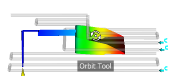

The Orbit tool enables you to change the orientation of a model in a 3-dimensional manner. As you drag the cursor, the model rotates around a pivot point, while the view remains fixed.
The pivot point is the base point used when rotating a model with the
Orbit tool. When you first open a model, the target point of the current view is used as the pivot point. You can change the pivot point on the model, using the
Center tool.
- Use the Orbit tool on the Navigation bar
- Click
Orbit on the Navigation bar.
- Hold down the left mouse button and move the mouse around the screen to rotate the model.
- Use the Orbit tool on the ribbon
- Click
- Use the Steering Wheel
Display the View Object or Full Navigation wheel.
- Left-click and hold down the Orbit wedge.
The cursor will change to the
Orbit cursor
- Move the mouse around the screen to rotate the model.
Note: Use the Center tool to re-center the model in the current view.
- Release the button on your pointing device, to return to the wheel.
