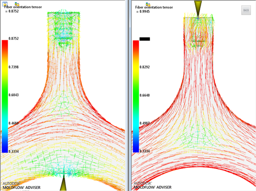

Fiber orientation tensor result
The Fiber orientation tensor result shows the degree of orientation of fibers at the end of the molding process.
The probability of fiber orientation being in the displayed direction is reported. A high probability is indicated by a value close to 1, whereas low values closer to 0 indicate the possibility of a more random arrangement of fibers in the finished product.
Understanding fiber orientation within a part can assist in understanding the mechanical properties of the finished product.
