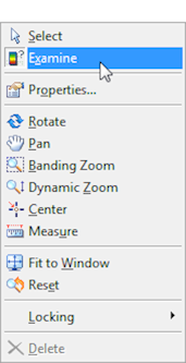

Right mouse click within the Work pane and the Examine function is the second item available.
