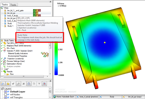

View study notes in a closed study
To save time, you can now view the study notes associated with a study, without first having to open the study.
Simply hover over a study in an open project. If there are study notes associated with that study, you will find them at the bottom of the dialog that opens, under the heading Study Note.
