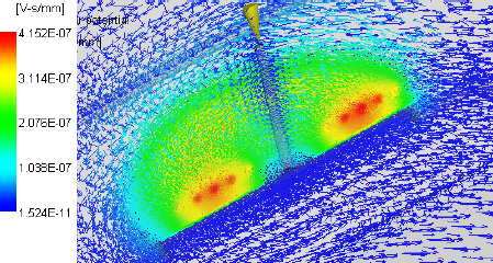

3D This result does not appear in the Study Tasks pane by default. Instead you can create it as a New Plot, after the analysis has run, by clicking
(). Magnetic vector potential is listed in the Available results.
This result is an intermediate result that can be viewed to get a better understanding of the Joule Heat result. Check the direction and magnitude of the vectors and confirm that they are of an appropriate size and direction.
Figure 1: Magnetic vector potential in the mold
