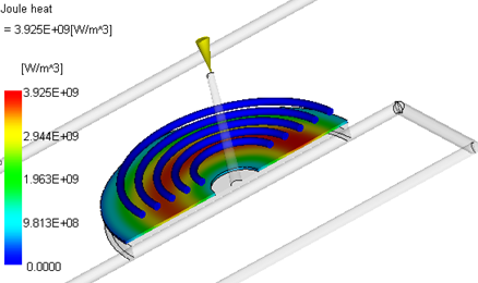

Figure 1 shows an example of the joule heat generated on a nickel insert surface which was placed directly above the part. The material properties of nickel mean it will heat relatively readily under the influence of an induced current.
Figure 1: Joule heat generated on a nickel insert surface

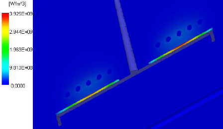

Figure 2 shows the heat generated in the mold/nickel insert combination on a cutting plane for the same model. Since the insert is made from nickel, which is better suited to heat generation more heat is generated in the nickel insert than in the ordinary tool steel used in the mold, especially in the skin depth of the nickel insert relative to the surrounding mold.
Figure 2: Joule heat generated in the mold and insert
