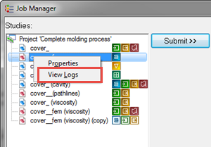

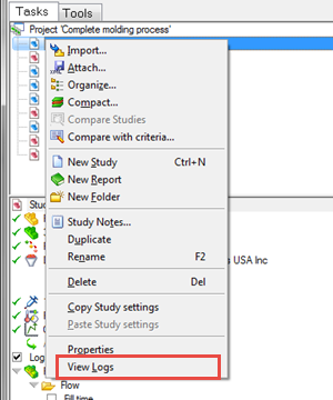

()), hover over a study in the Studies list, then click the right mouse button and select View Logs from the drop-down menu

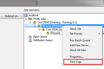

()), hover over an analysis in the Job servers list then click the right mouse button and select View Logs from the drop-down menu
In all cases, the study logs will open in a new window, with all the log tabs available for selection.
