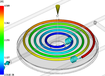

3D This result does not appear in the Study Tasks pane by default. Instead you can create it as a New Plot, after the analysis has run, by clicking
(). Source electric potential is listed in the Available results.
This result is an intermediate result that can be viewed to get a better understanding of the Joule Heat result. Check that the magnitude of the electric potential is as expected based on your analysis setup.
Figure 1: Source electric potential in the coil
