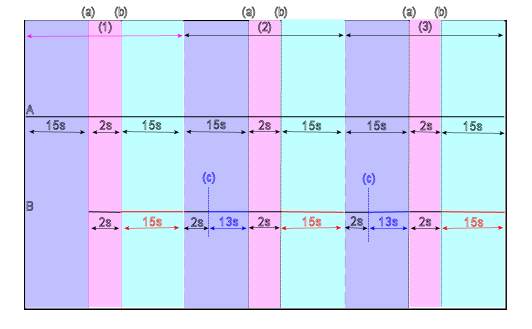

In this mode, the mold is heated and cooled for a specific length of time. You can select whether to heat the mold when it is open, or closed, by setting the timings appropriately. For example in the illustration below, the mold is heated while it is closed (illustrated by the red 15s):
Example programming, A, for three injection molding cycles with simultaneous mold heating and cooling, B.
where A is the injection molding cycle, as programmed in the Process Settings dialog, and B is the mold rapid heating and cooling settings, as programmed in the Rapid Heating and Cooling inlet dialog. (1) is cycle 1; (2) is cycle 2; (3) is cycle 3; (a) is mold open; (b) is mold close; (c) is when coolant enters the cooling channels.
In the illustration above, the injection molding cycle, A, as programmed in the Process Settings Wizard dialog, starts with an   Injection+packing+cooling time of 15 seconds (s). The   Mold-open time is 2s, during which time the part is ejected, then the mold closes again. Once the mold has closed, a 15s   Mold-close time before injection delay is programmed, then the cycle repeats itself.
Meanwhile, in the Rapid Heating and Cooling inlet programming, B, when the mold opens at point (a), there is a Secondary air purge for 2s to clear the cooling channels of coolant prior to heating. The mold closes at (b), and heating fluid enters the channels for 15s during the Mold-close time before injection delay. While cycle 2 of the injection molding process commences with Injection+Packing+Cooling time, the coolant lines undergo a Primary air purge for 2s to remove all traces of heating fluid, then coolant enters the cooling channels for the final 13s of the Injection+Packing+Cooling time.
