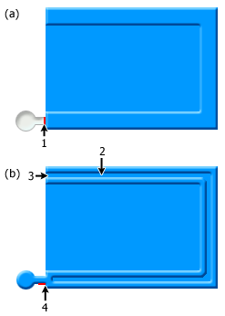

The following figure illustrates the typical application of overflow wells in gas-assisted injection. The passage to the overflow well is generally closed during the injection phase while the plastic is filling the rest of the cavity, as illustrated in a) below. At the end of polymer injection, there is an optional delay time which allows the polymer over the thin sections to solidify. Immediately before gas injection is triggered, the passage to the overflow well is opened, creating an additional volume to accommodate the resin that is displaced by the incoming gas, as illustrated in b) below. After the part is ejected from the mold, the overflow can be trimmed off if it is undesirable.
Overflow wells
Legend:
1) Control valve closed during polymer injection. 2) Gas penetration. 3) Gas entrance. 4) Control valve open during gas injection.
