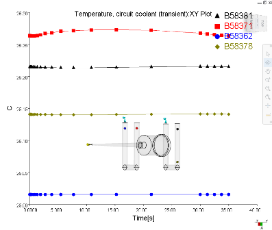

The Temperature, circuit coolant (transient) result shows how the temperature of the coolant in the cooling channels changes over the duration of the cycle.
Using this result
Use this result to determine whether the cooling channels are cooling effectively, and whether their placement will affect cycle time and part warpage. If there are hot or cool spots, you may need to adjust the cooling channels, or coolant temperature. Cooling channel placement and the thermal conductivity of the mold will affect the temperature variations.
Tip: You can create an XY plot of the transient circuit coolant temperature, on any given node, to see how the temperature at that node varies with time. Click (Results tab > Plots panel > New Plot > Plot) and scroll down to the result. Remember to change the Plot type to XY plot.
