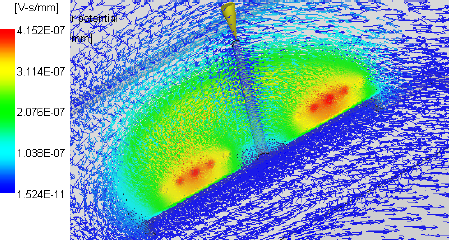

This result is an intermediate result that can be viewed to get a better understanding of the Joule Heat result. Check the direction and magnitude of the vectors and confirm that they are of an appropriate size and direction.
Figure 1: Magnetic vector potential in the mold
