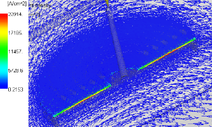

The induced current is an alternating current and should be strongest in the skin depth, in the skin region of the mold inserts, or in the insert that is in contact with the part. This plot enables you to verify this, obtain the strength of the current, and know where the mold will heat up. You can also see the direction of the current. This result is dependent upon the material properties of the mold insert. Figure 1 provides an example of the induced current density result, showing the direction of the current, and the stronger current in the skin region of the mold insert.
Figure 1: Induced current density in the mold

  • The current should be strong in the skin region of the insert where heat is desired.
