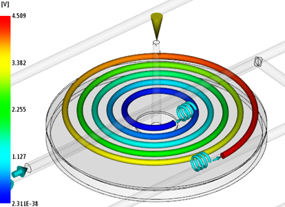

This result is an intermediate result that can be viewed to get a better understanding of the Joule Heat result. Check that the magnitude of the electric potential is as expected based on your analysis setup.
Figure 1: Source electric potential in the coil
