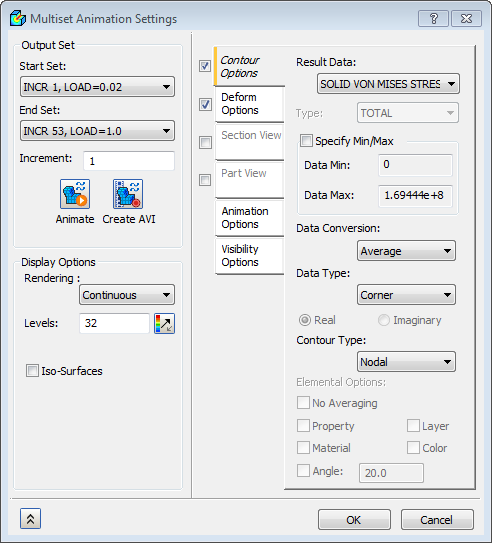

- You can animate the punching of the sheet which follows the shape of the punch and die.
- Right-click
Results and select
Multiset Animation Settings. Change the
End Set to the last step. Select
SOLID VON MISES STRESS and change the
Delay to
100 in
Animation Options. Make sure the
Deform Options and
Contour Options are selected and the
Deformation Scale is set to
Actual.
- Click on the
Animate button. This will load the animation.
- Click on
Hide All button in
Visibility Options section.
- It may be necessary to zoom into a more localized view to see the bodies contact.
- To save the animation as an AVI file, click on the
Create AVI button. Name the file
PunchDieAnimation and click
Save.
- Click
OK to exit the
Animation Settings.
