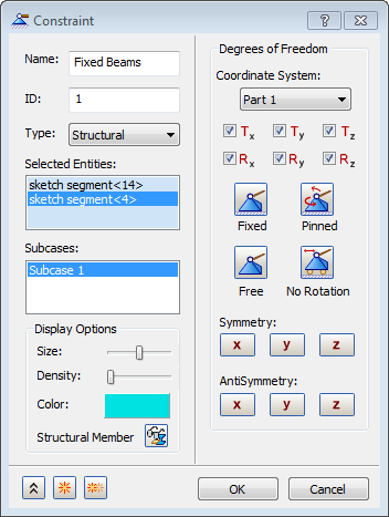

  1. In the tree view, right-click on Constraints and choose New.

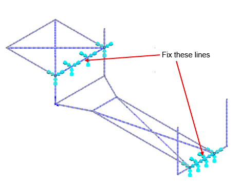

  2. Rename the constraint to Fixed Beams.
  3. Select the lines to fix, as shown in the figure below.
  4. Be sure that Subcase 1 is selected in the Subcases list.
  5. Leave all the defaults in the Constraint dialog.
  6. Click OK to create the fixed constraint.
