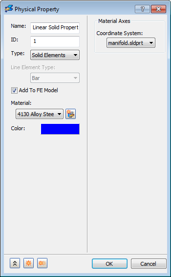

Define the Element Properties
Right-click on
Physical Properties
and select
New
Type
Linear Solid Property
for
Name
, and select
Solid Elements
under
Type
Click
OK
