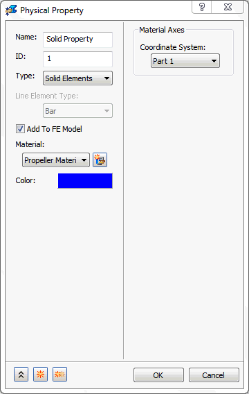

Define the Element Properties
In the tree view, right-click on
Physical Properties
and choose
New
Rename the property to
Solid Property
Select
Solid Elements
from the
Type
drop-down menu. Accept the selected defaults.
Click
OK
to create the property.
