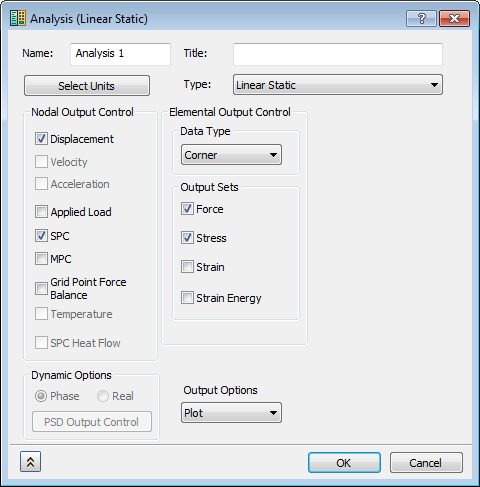

Set Up and Run the Analysis
In the tree view, right-click on
Analysis 1
and select
Edit
Check
Force
for
Output Sets
under
Element Output Control
Click
OK
Save the model.
Right-click on
Analysis 1
and select
Solve in Nastran
