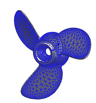

Define the Mesh
Right-click on
Mesh Model
and choose
Edit
Type
1
in the
Element Size
field under
Global Settings
Accept the defaults and click
OK
to generate the solid mesh.
After the mesh is generated, the model should look as shown below.
