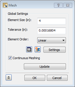

Define the Mesh
Right-click on
Mesh Model
and choose
Edit
Enter
4
for the
Element Size
. Make sure the
Element Order
is set to
Linear
Click
Update
to mesh the geometry and then click
OK
