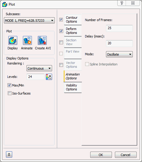

- In the tree view, right-click on Results and select Edit.
- From the Subcases drop-down menu select MODE 1, FREQ=628.57233. Make sure that Contour and Deform are checked.
- Click on the Animation Options tab.
Number of Frames = 25
Delay (msec) = 20
Mode = Oscillate
- Click OK.
- Right-click on Results and select Animate. You should see the contour and deformation animated.
- Right-click on Results and select Animate once more to stop the animation.
- Right-click on Results and select Edit.
- Uncheck the Contour checkbox. Notice that the displacement contour plot is no longer being interpolated along with the deformation plot.
