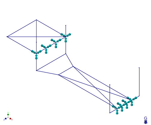

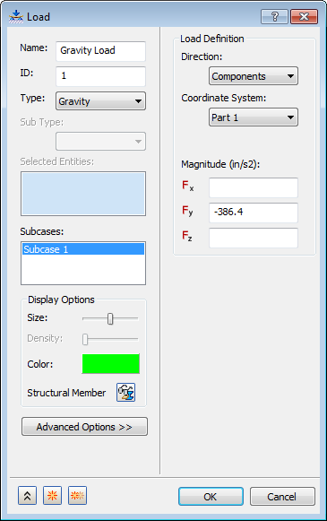

Apply the Loads
Right-click on
Loads
and choose
New
Rename the load to
Gravity Load
Select
Gravity
for
Type
. Type
-386.4
in the
Fy
field under
Magnitude
Click
OK
to create the load.
