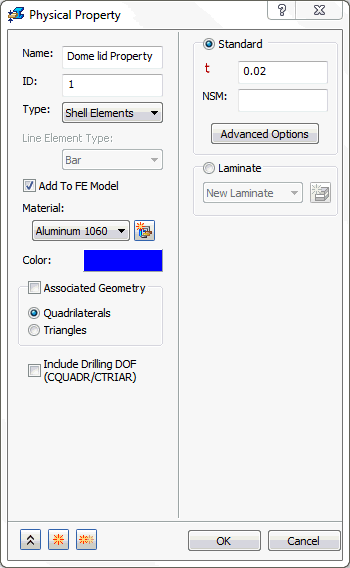

Define the Element Properties
  1. In the tree view, right-click on Physical Properties and choose New.
  2. Rename the property to Dome Lid Property.
  3. Select Shell Elements from the Type drop-down menu.
  4. Make sure Add to FE Model is checked. Then enter 0.02 in the t (thickness) field.
  5. Make sure Quadrilaterals are selected under Associated Geometry.
  6. Click OK to create the property.
Associated Geometry is not needed in this case. When associated geometries are not defined, all the shell elements will then have this property defined. This is used when there are multiple shell properties (i.e. multiple shell thicknesses) throughout a model.
Nonstructural mass can be added to each element in case there is an attached mass that you don’t want to physically model, but want to include in calculations.
