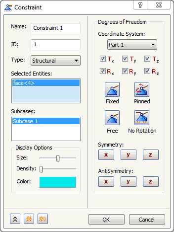

Apply the Constraints
In the tree view, right-click on
Constraints
and choose
New
Select the wider end of the wing.
Click
OK
to finish defining the constraint.
