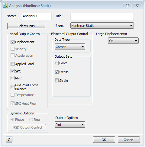

Set Up the Analysis
In the tree view, right-click on
Analysis 1
and select
Edit
Select
Direct Transient Response
from the
Type
drop-down menu.
Check the
Velocity
and
Acceleration
checkboxes.
Click
OK
