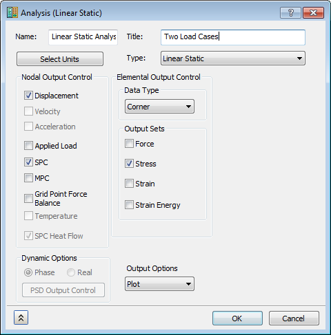

Set Up and Run the Analysis
Right-click on
Linear Static Analysis
and choose
Edit
. Type in
Two Load Cases
for
Title
Click
OK
Save your model.
Right-click on
at the top of the tree view and select
Solve in Nastran
