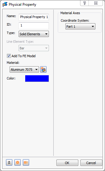

Define the Element Properties
In the tree view, right-click on
Physical Properties
and select
New
Select
Solid Elements
from the
Type
drop-down menu.
Click
OK
