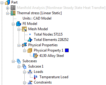

Apply the Loads
  1. Right-click on Loads under Subcase 2 and select New.
  2. Change the Name to Temperature Load.
  3. Change the Type to From Output.
  4. In the Load Definition section click on the browse button for the Results File. Navigate to the location of the FNO file, which was generated after running the Nonlinear Steady State Heat Transfer Analysis. For example, C:\Users\Public\Documents\Autodesk\Nastran In-CAD 2016\Tutorial\en-us\Inventor folder. Then open Manifold Analysis.FNO.
  5. The Load dialog shows that 1..INCR 1, LOAD=1.0 is selected as the Output Set and TEMPERATURE is selected for the Nodal Load, as shown below.
  6. Click OK to complete the load definition of temperature load from output.
