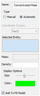

When selecting the Automatic option on the Concentrated Mass form, the following sections are available:
- Selected Entity: This box allows you to select solid bodies that will be represented by a mass element at the body’s center of gravity (CG).
- Mass: This outputs the total mass based upon the density that is input for reference.
- Density: Input of the selected solid body’s mass density.
- Display Options: Allows you to edit the display options of the concentrated mass.
- Size: Changes the size of the concentrated mass.
- Color: Allows you to pick the color of the concentrated mass.
- Add To FE Model: This checkbox automatically puts this concentrated mass under FE Model.
