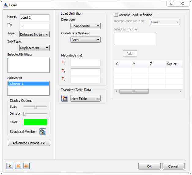

If Type is set to Enforced Motion, then the dialog will look as shown below.
Enforced motion encompasses loads such as displacement, rotation, velocity, acceleration, rotational velocity, and rotational acceleration. Accelerations and velocities can only be applied and accessed in dynamic analyses. Enforced motion can be applied to curves, surfaces, and vertices.

Enforced motion can have a variable load definition as well as custom display properties such as color, size, and density.
