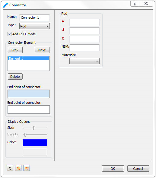

Connectors can be defined by right-clicking on Connectors in the Model tree and selecting New to open the window below.
The other sections in this form vary sightly depending on the Type selected. Click on the links at the bottom of the page to see more info on the other sections available in this form.

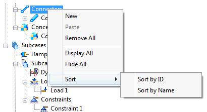

Connectors can be dragged and dropped from the Model tree onto the FE Model.
Once Connectors is added to the FE Model it creates a single node with all the connectors. This will allow you to create a new connector without going to Model tree. Connectors can also be selected from here to be included in the analysis model.
If you right-click on Connectors in the FE Model tree section, the following options are available:
