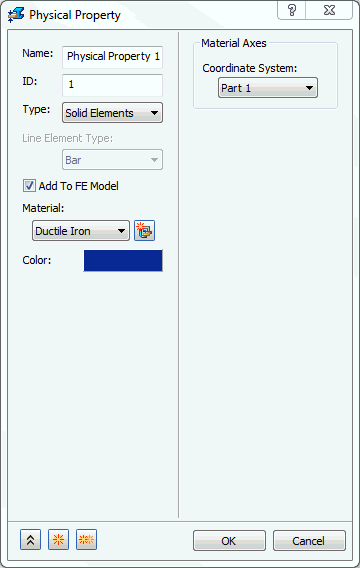

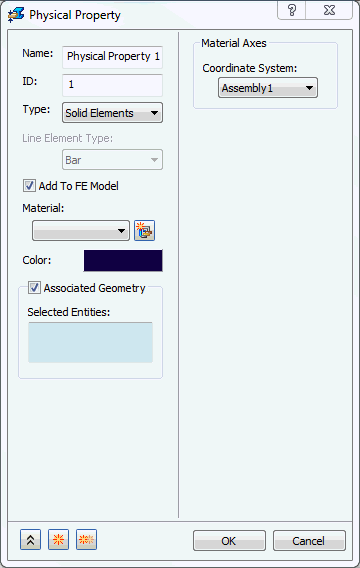

Select the Solid Elements option under Type in the Physical Property form. You will notice that solid elements can only be selected in Assembly context.
Part Context
Assembly Context
