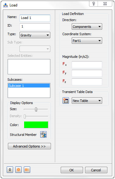

Gravity
If Type is set to Gravity, then the dialog will look as shown below.
Gravity is a global translational acceleration vector and will only act on those bodies that have a mass density defined in the material definition.
Gravity is indicated by a small vector located in the lower right corner of the graphics window. The arrow indicates direction. The color and size may be edited in the display options section. Display density has no effect.
